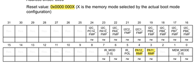

I am currently working on a small device with a C071GBU. This is the first time I am using a chip with shared pins (PA12/PA10 and PA11/PA9) as well as no dedicated single-function BOOT0 pin.
My PCB has very tight space constraints, so software debugger or programming pads are no option - everything must work via the USB port, from first time setup on.
If I understood the specsheet correctly ("Pins PA9 and PA10 can be remapped in place of pins PA11 and PA12 (default mapping), using SYSCFG_CFGR1 register"), PA12/PA11 are default (and not PA10/PA9), so a fresh chip out of the box can be used for USB DFU, am I correct in this assumption?

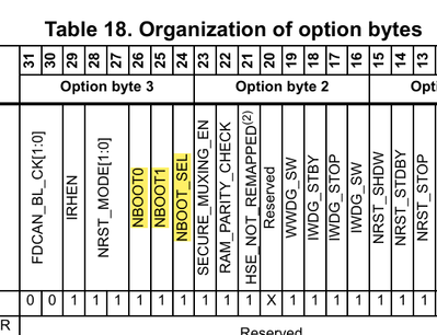

Then there is my next question - how does BOOT0 work? If I understand correctly, the boot selector bits decide whether PA14 is BOOT0, or whether a software bit is used. The patterns in AN2606 are as follows:
What I do not understand - how are the defaults? As in, if I have a fresh chip directly from the factory, how is it set up? Will PA14 operate as BOOT0 out of the box, or is this something I have to manually set in a first-time-flash? If the flash memory is empty the chip should always default to entering the bootloader, so I can flash a firmware that sets the correct bits through USB, and from there on PA14 is BOOT0, correct? I am sorry for asking questions that may seem trivial - bootloader patterns have been confusing me before, and I would prefer a prototype that works at least well enough to test all important features. This is a personal project, so prototyping funds are limited.

PA11/PA12 are used until you remap them. This has to be done after powerup--it is a volatile setting.

Default option bytes are nBOOT0 = nBOOT1 = nBOOT_SEL = 1. But since the flash is empty, the USB bootloader will load the first time it's powered (third pattern in the table).

So summing it up - A11/A12 will be default, and entering USB DFU out of the box is no problem. Then I can set nBoot_Sel to 0 at the first flash, and from that point on pulling boot0 high at boot will enter bootloader, and once the chip boots into program memory PA14 is available as a regular GPIO.

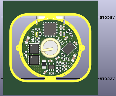

2025-02-15 11:02 AM
Hi Hans,
the switched wires make sense. Yeah, things like these happen, even to the most experienced ones. Part of the reason why we have strict reviews of both schematic and PCBs by at least one other person at work. I sometimes wish I could sneak my personal projects in and know they are good before ordering haha.
True, 100n on nRST would be nicer, but there is just no way for me to squeeze a cap anywhere near the MCU. The internal pull-up will have to suffice. I am already violating courtyards all over this board.
It's a prototype of a pretty niche product - a flashlight controller PCB. 30W boost converter for a LED, 15W USB-C charging/powerbank controller with battery management, and the C071 to control it all on a 20mm PCB where most of the outer rim is reserved for electrically and thermally contacting the flashlight housing. I hope it will end up working as intended.
