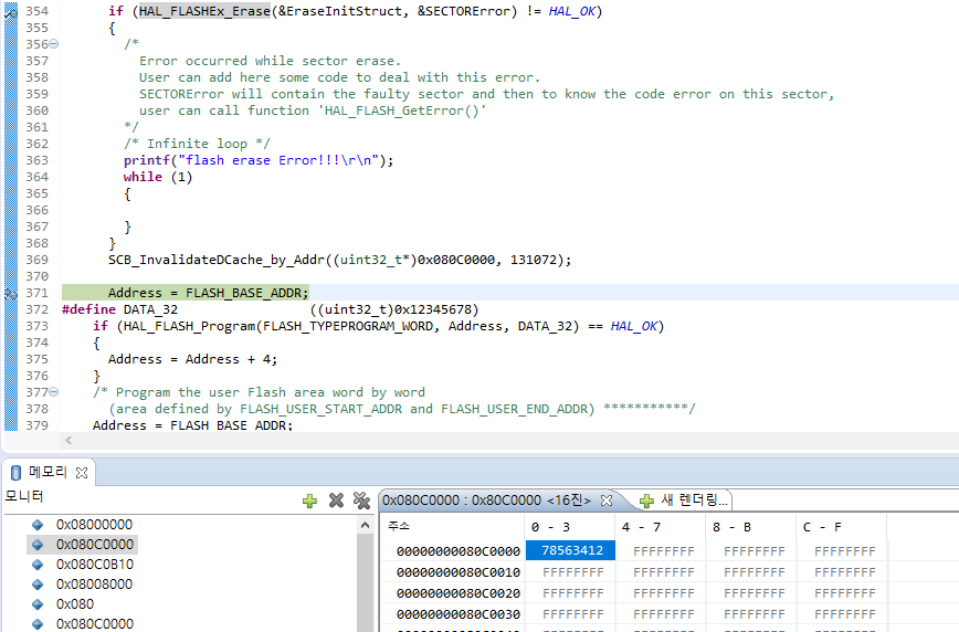

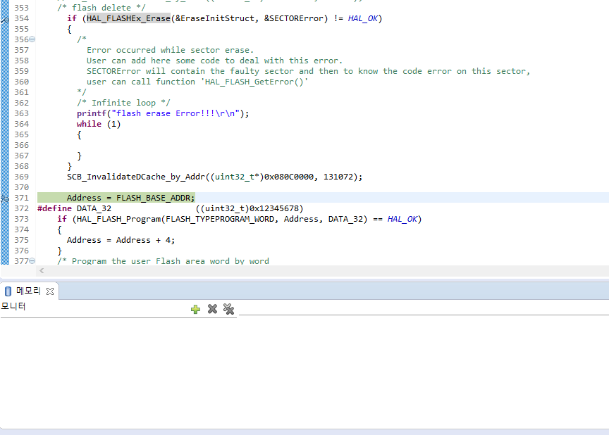

if (HAL_FLASHEx_Erase(&EraseInitStruct, &SECTORError) != HAL_OK)
Error occurred while sector erase.
User can add here some code to deal with this error.
SECTORError will contain the faulty sector and then to know the code error on this sector,
user can call function 'HAL_FLASH_GetError()'
/* Infinite loop */
printf("flash erase Error!!!\r\n");
while (1)
SCB_InvalidateDCache_by_Addr((uint32_t*)0x080C0000, 131072);
Sorry, i changed.
2. So i execute rest of my code and restart the debugger, then i could see the memory.
3. I disconnected power supply, and i reconnecting power supply. and connect with ST-LINK_UTILITY.

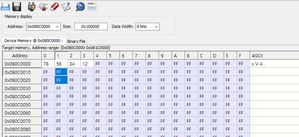

2020-07-07 5:26 AM
You still have HAL_FLASH_Program() called after erase. Do the erase without it (comment it out) and then look at memory with ST-LINK Utility!
2020-07-07 5:26 PM
memory 0x080C0000 : 78563412 FFFFFFFF FFFFFFFF FFFFFFFF
3. downloaded the firmware below which is removed HAL_FLASH_Program();
. and truestudio show me the error but i ignore that
message. and close debug and see the memory with STM32-LINK-Utility
