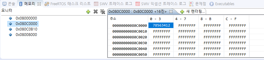

Hi All.
I work with stm32f767igt for using flash.
The code below is erasing and writing flash.
I succeed writing the flash.
But when i try to delete the flash with
HAL_FLASHEx_Erase(&EraseInitStruct, &SECTORError) ;
and
FLASH_Erase_Sector(FLASH_SECTOR_10 ,FLASH_VOLTAGE_RANGE_3);
it didn't work properly.
So i can't update data in flash because flash doesn't deleted.
What am i doing wrong?

thank you for your quick reply.
Yes. the HAL_FLASHEx_Erase returns HAL_OK otherwise it stuck in while(1).
i didn't set any option realted with DUAL_BANK.
how do i check the option bytes?

I program like this, but it didn't work.
How do i use this function correctly?

Yes. . . I added after erase flash() ,,too
But , not working
Also i have tested on nucleo-144 stm32f767ZIboard, it works.
