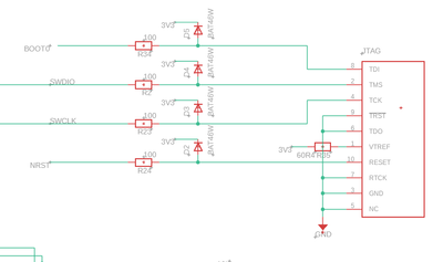

As for protecting the MCU against this problem, would something like this work?
In my current design (of which two prototypes now was broken due to latching NRST pints) I already have in-line resistors for the SWD and NRST signals (they where 22ohm as per STM's design guide, but I uped them to 100 now). If I clamp all four signals with a BAT46w(0.3 Vf) Schottky, that should prevent the SWG signals and NRST pin of the MCU getting pushed above Vcc.
I see now in the ESD guidelines of STM's AN5612 appnote they suggest another setup for ESD protection using a 4channel TVS, but that would not protect against this specific case where the ST-Link is applying voltage to NRST or SWD pins above the MCU's Vcc (e.g. the PCB is not powered).
Im not too worried about ESD for this project in general as it will be mostly used in lab conditions, so protection against inadvertently messing up the connection procedure for ST-Link debugger is more important.
