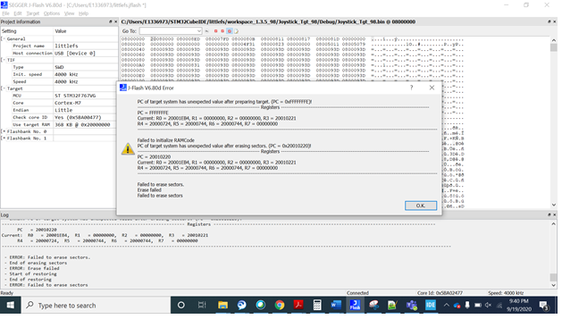

I've tried erasing STM32F767VG through JFlash tool, but there I get error,below is the log from JFlash tool, sometimes it gives RAM read error(picture is attached)
did anybody faced similar issue, any clue to resolve it?

2020-09-22 12:12 AM
Tried erasing sectors from 0x08000000 but it gives error, is it because of flash is corrupted?

2020-09-22 9:50 AM
Please don't PM on threads.
I don't have any specific experience with the Segger Debugger
You'd probably want to ponder what changed in your code or system between the time it worked and stopped working.
Software updates/installs.
Changes to code related to flash, pins, debug settings, etc.
If you had additional boards you could at least make a determination if it is a chip level issue, or a more systemic one.
See if it follows onto a second computer, using different ports, cables, etc.
