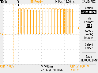

Below is the output am getting for this code. As you can see, i should have got 20 pulses having higher duty cycle but i got only 15.

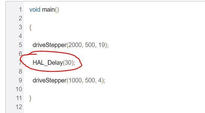

For clarity am including the core part of the code here. In this code i have used 30ms delay which works ok.
void main()
driveStepper(2000, 500, 19);
HAL_Delay(30);
driveStepper(1000, 500, 4);

Hi Jan,
Am using delay as shown below.
2020-08-22 12:32 AM
According to the waveform you posted, 30ms is good for only the first 15 pulses, so why the surprise then?
