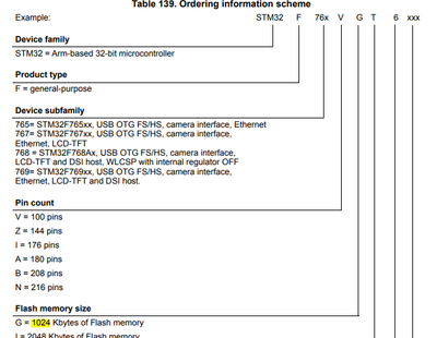

We use STM32F765VGT6 in our product. The datasheet says 1MB of flash memory available but it looks like there is 2MB available for use 0x0800 0000 to 0x081F FFFF.
Is this a documentation issue? Can we use the extra 1MB flash starting from 0x0810 0000 to 0x081F FFFF?

The STM32F765VGT6 has 1024 Kbytes of Flash memory as indicated on the STM32F765xx datasheet.
ST does not guarantee the flash behavior outside of the region specified in the Datasheet, and all access outside of this memory area is considered as "Out of specification".

What do you mean by overwritten? If you don’t access this region nothing else could do it.
This region is accessible by the user but we cannot guarantee its good operation since it was not tested in the ST factory. So if the user needs to use it he has to do it on his own.
2024-03-25 1:38 AM
the chip is the same in 1M or 2MB version; just only the memory, you pay for, is tested and guaranteed to work 100%.
The other memory is same as in 2MB version, but up to you, to use it and test it. ("usually" its working as it should, hey - is the same chip. Just no guarantee , you didnt pay for the test. )
The area is not "forbidden " and its up to you only, to overwrite it, if your program has an error and doing this.
