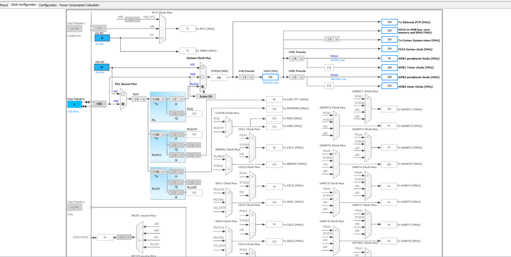

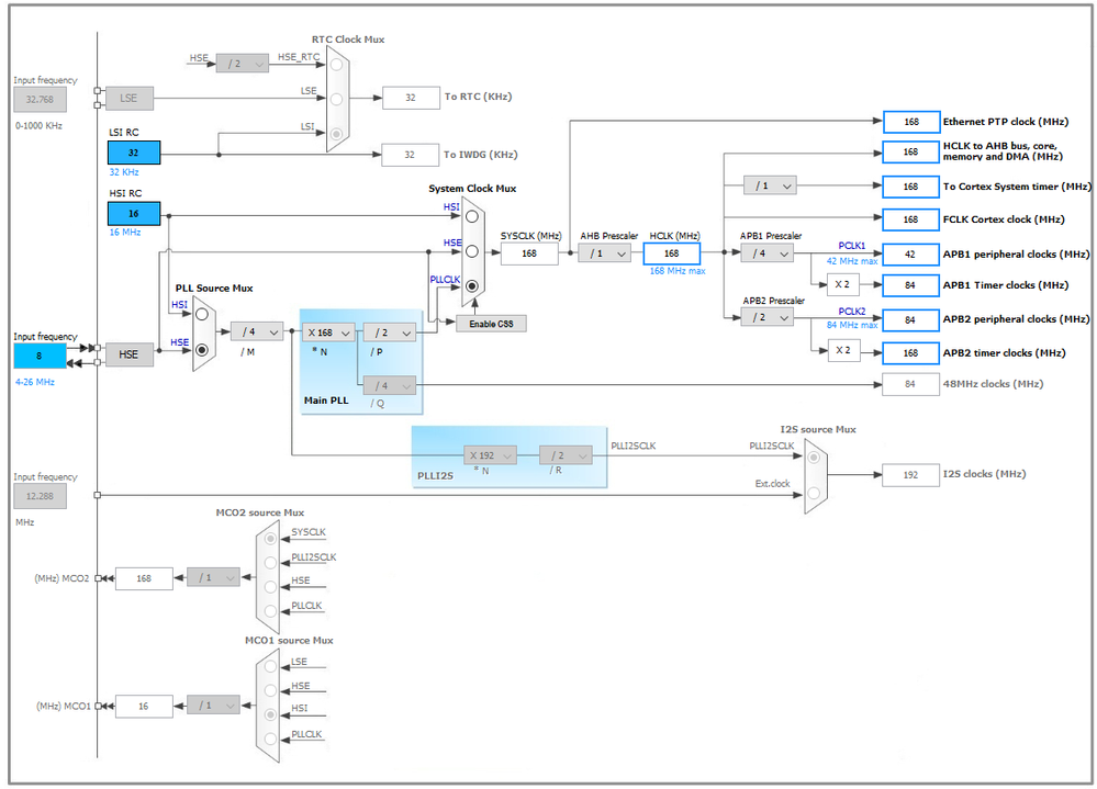

2018-06-21 12:34 AM
Im not sure what do you mean by ''
switching on compiler optimization''. Guess its not about CUBEmx clock optimization.
But anyway this is my clock config for both mcu's:
F4:
F7:
