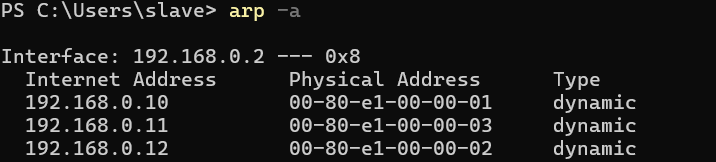

I tried disabling DCHP, removing the fetch function on the recv callback, changing computers, changing routers, switches and cables but still no fix. I tested the connection on the terminal with the command "ping -t 192.168.0.1x" and saw that the connections alternated throughout the process every few seconds (the connections would return "Request timed out." when there was another connection being pinged), I also searched about this on the internet and it seems that people don't usually use multiple clients running continuously in real time (they use multiple servers and ports instead of multiple clients), I wonder if using multiple clients in real time is really possible with TCP?
Can anyone here do this?

Ok i found !! it's slow because they have the same MAC address so i changed them
