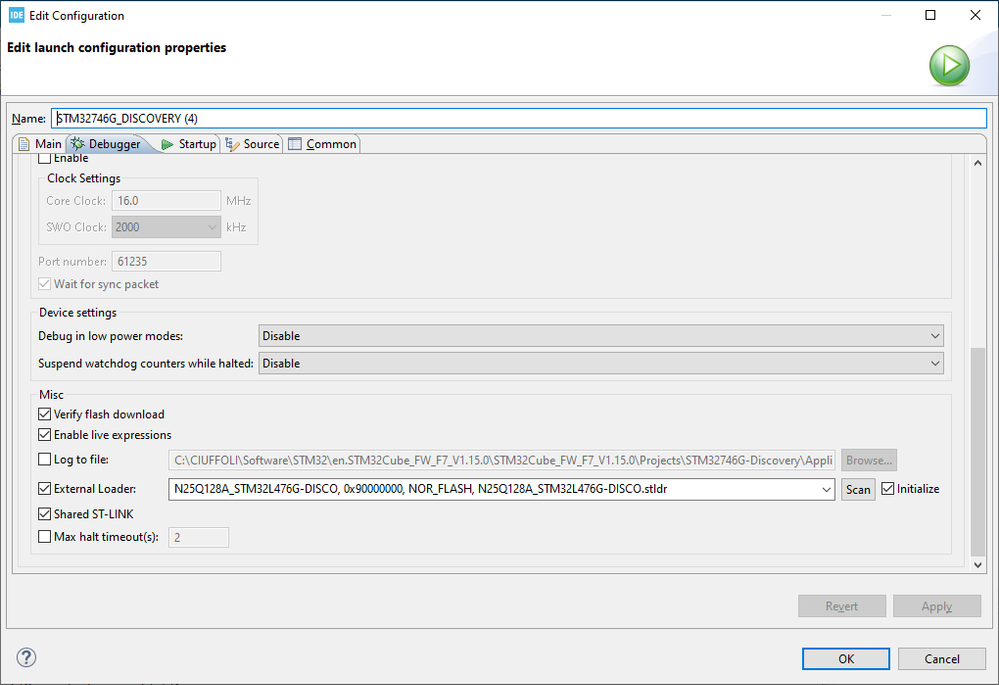

}and this setting N25Q128_STM32F746-DISCO

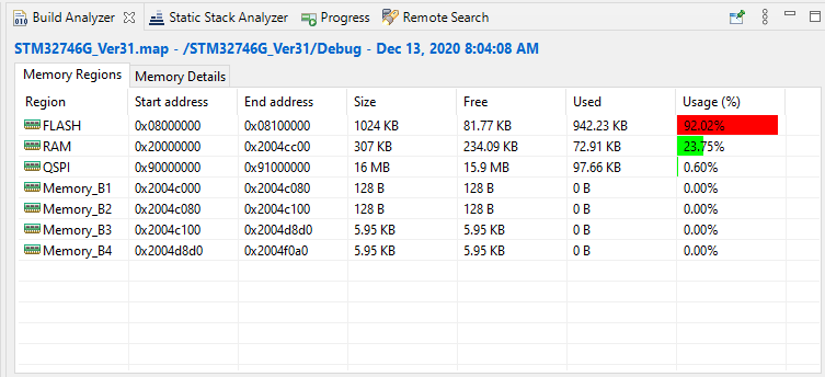

the compile phase now it is ok
I see the QSPI data in the STM32746G_Ver31.map

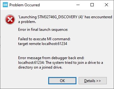

but I get the error during the flash phase of the external QSPI
STMicroelectronics ST-LINK GDB server. Version 5.7.0
Copyright (c) 2020, STMicroelectronics. All rights reserved.
Starting server with the following options:
Persistent Mode : Disabled
Logging Level : 1
Listen Port Number : 61234
Status Refresh Delay : 15s
Verbose Mode : Disabled
SWD Debug : Enabled
InitWhile : Enabled
Failed to initialize external memory!
Error in initializing ST-LINK device.
Reason: Unknown. Please check power and cabling to target.solved with ST-LINK Server and this settings

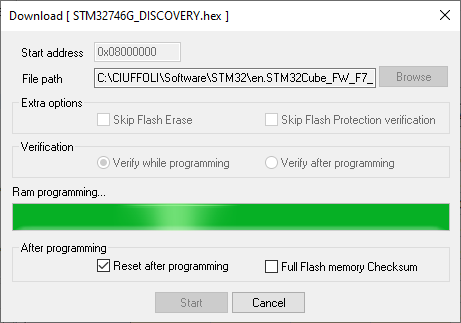

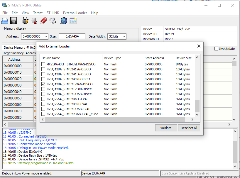

2020-12-12 11:31 PM
Using the ST-LINK outside the CubeWorkspace it run
and I see the value "pippo"
