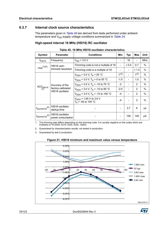

Microcontroller may be; STM32L0 or L4
Required; 5% worst case over -5 to 50'C
The microcontrollers are quoted 1% accurate at 25'C but I can not find how accurate they over the ICs temperature range. I want to avoid trimming or fitting a crystal.
The application does not require a lot of processing and includes battery power and charging so an Fxxx variant or other may be suitable if temperature range is specified?
2020-12-13 4:00 AM
you'll find similar information for other internal oscillators too. For other STM32 model, refer to its datasheet.
2020-12-13 4:00 AM
2020-12-13 4:17 AM
Thanks I seem to look but not find all that I was looking for.
