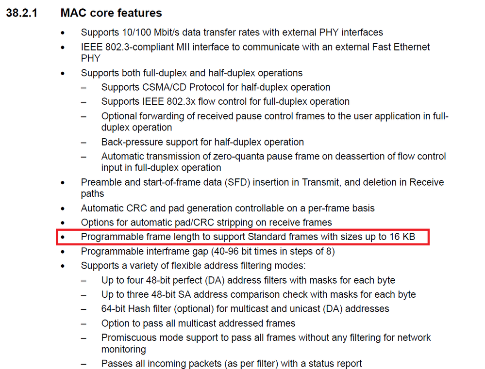

I have been trying to implement a TCP server on a STM32F745ZG MCU using lwip library and ST example codes, however while I am trying to send data packets with payload bigger than 1460 bytes, my server wont be able to replay the client packet and the connection stops.
I know the ethernet standard MTU is 1500 bytes and the corresponding MSS is 1460, so i tried to increase mtu in both "ethernetif.c" and "lwipopt.h" files and also check this MCU reference manual and it seems it support bigger data packet size:
However, i still have no success in sending TCP payload bigger than 1460 Bytes.
Any help or hint would be highly apprecited.
But does LwIP support larger packet sizes?
Remember that the "Lw" in "LwIP" stands for light-weight - so maybe it's just a limitation of the stack?

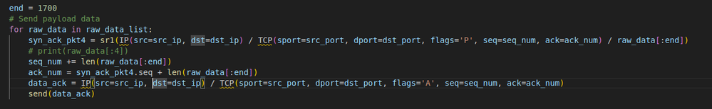

Thanks a lot for your message.
using this solution, will I be able to acknowledge a received packet with around 1700 bytes of payload with two smaller packets from my server?( i am using a python script by scapy library act as a TCP clients which send the data to sever, and it gonna continue sending the packets only if it receive the complete reply from server)
here is my client side code:
and here is my server side code for handling the received packet:
