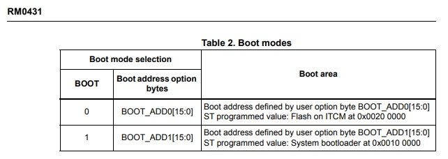

It doesn't have a BOOT1 pin, perhaps you're thinking of the older F1 devices?
BOOT0 = 0 / LOW - USER CODE
BOOT0= 1 / HIGH - SYSTEM LOADER ROM
You should pull down the BOOT0 pin to ensure normal operation of custom board designs
There may be additional options in Option Bytes

Cite the actual document, I'm not going to go fishing for it, pretty sure the Data Sheet and Reference Manual don't mention BOOT1, I searched through them this morning.
2023-03-23 11:44 AM
The Reference Manual is the controlling document as to what the device expects.
The Data Sheet covers the physical pin assignments and expectations.
This device doesn't have a BOOT1 pin, and it is not assigned to PB2
You could use PB2 as a GPIO and alter what you do in your code when it boots, say put it in DFU mode, or whatever.
The Option Bytes can be changed to point to different memory addresses. A device modified in such a way might be a challenge to recover.
