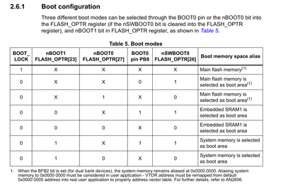

you can check the STM32G474R reference manual, there is no boot1 pin, but nSWBOOT0, nBoot0, nBoot1.
if the Boot0 s high, and
2026-04-26 8:28 PM
if the Boot0 s high, and nswboot0 is 1, you need to check also the nboot1 value
