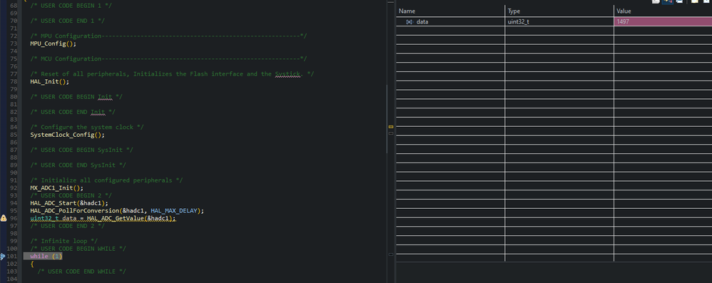

It's weird. I have nucleo F7, set 108 Mhz , 480 cycles and others like you and works without problems. Maybe share your code?

I have it running on STM32F767, but in sequence mode with DMA:
