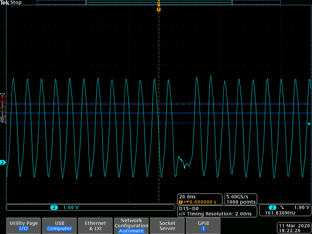

With a long row of similar commands in the while loop like
void RAMFUNC FastToggle(void)
GpioPinConfigSet(NUTGPIO_PORTB, 10, GPIO_CFG_OUTPUT |GPIO_CFG_SPEED_HIGH);
volatile uint32_t *gpiob_bsrr = &GPIOB->BSRR;
uint32_t on = (1 << 10);
uint32_t off = (1 << ( 16 + 10));
while(1) {
*gpiob_bsrr = on;
*gpiob_bsrr = off;
*gpiob_bsrr = on;
*gpiob_bsrr = off;
I get following scope picture. The one prolonges cycle is when the while loop jumps back:
Running at 216 MHz I get about 202 MHz change rate at the GPIO.

> Datasheet simply indicates fast I/Os up to 108MHz is possible
It's possible up to 108MHz as in "Sale! Up to 50% off!". Setting OSPEED ensures that signal rise and fall times are tight enough for 108MHz.
> so I assumed one clock to set and one to clear the state of the pin.
Maybe, if the machine instructions are optimized for that. Data already present in registers, back-to-back str instructions to GPIOx->BSRR.
