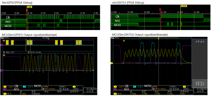

I recently replaced an existing STM32F767 MCU with a new STM32H753 MCU in my project that involves SPI communication with an FPGA using 16-bit data frames. After the replacement, I encountered issues with SPI read/write timing and overall communication stability.

=====================================================================Observed Issues
- SPI communication that was stable on STM32F767 shows timing mismatches and unreliable data transfer after switching to STM32H753.
- Using hardware NSS output versus software NSS control seems to affect timing.
- SPI clock prescalers and timer configurations may behave differently between the two MCUs.
- DMA configurations are consistent but cannot completely resolve timing issues.

2025-10-31 6:16 AM
Are pins set to VERY_HIGH frequency?
