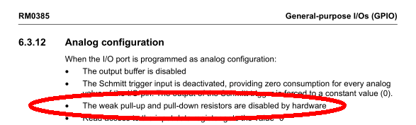

IMO 5V-tolerant pins disconnect pullup/pulldown when switched to analog mode.

Thinking I agree with you.
It has nothing to do with pull-up/pull-down configuration. It rather sounds like a deeper understanding of a SA-ADC is missing.
