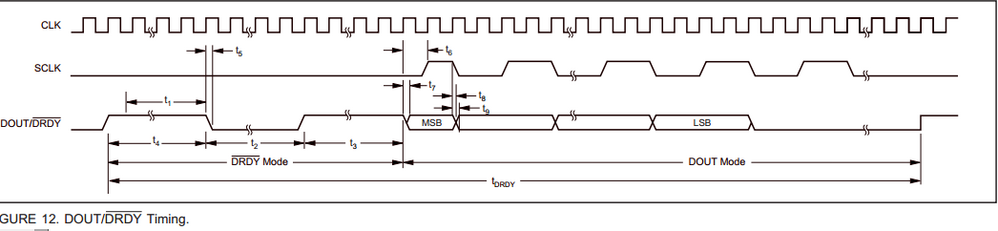

2017-06-13 8:25 AM
2-wire serial interface? like this?
Should I configure the EXTI pin (PA3) in the callback function as input mode everytime the interruption happens? (and then, before exiting to re-configure as EXTI)

Finally, it is not needed to reconfigure PA3
But I think that everytime DRDY falls during DOUT Mode, the interruption begins again.
Should I disable the interruption during DOUT Mode?
