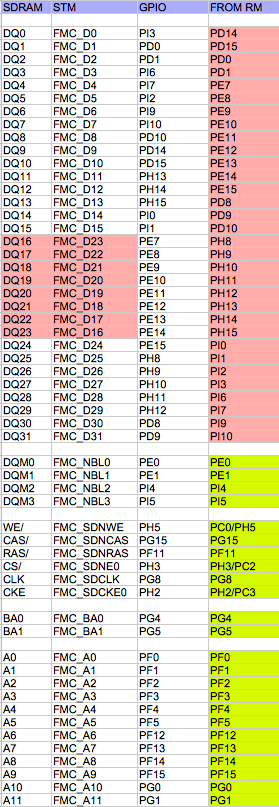

Ok I tested the DISCO code, with proper conf for my board, and the behaviour is exactly the same. It's working for 32 bit, but not for 8 bit.
I updated the schematics from my previous post with more hi-res files, sorry about that.
I noticed something when checking the pinout :
The three first columns are what I actually have wired on the PCB. You can see that the third block of eight pins (DQ16 : DQ23) are reversed.
I also noticed that none of the data pins are wired on the GPIO like indicated on the reference manual (last column).
Could it have an impact on the outcome of my read/write attempts?
2019-04-05 8:44 AM
Because your data bus is all muddled up. The byte positions don't match up with the signals.
2019-04-05 8:54 AM
Yes, going through it now, the byte positions are muddled up.
Bit reversal within the byte would be tolerable, probably, but the byte lane signals would need to map properly, and the bits here don't map well
As I see it D0..D7 on schematic map to D27, D2, D3, D28, D29, D26, D30, D31 (mix of lane 3 and lane 0)
At a bit level I think this will impact the config words written also
2019-04-05 9:09 AM
BOARD PIN STM32F769
D0 PI3 D27
D1 PD0 D2
D2 PD1 D3
D3 PI6 D28
D4 PI7 D29
D5 PI2 D26
D6 PI9 D30
D7 PI10 D31
D8 PD10 D15
D9 PD14 D0
D10 PD15 D1
D11 PH13 D21
D12 PH14 D22
D13 PH15 D23
D14 PI0 D24
D15 PI1 D25
D16 PE14 D11
D17 PE13 D10
D18 PE12 D9
D19 PE11 D8
D20 PE10 D7
D21 PE9 D6
D22 PE8 D5
D23 PE7 D4
D24 PE15 D12
D25 PH8 D16
D26 PH9 D17
D27 PH10 D18
D28 PH11 D19
D29 PH12 D20
D30 PD8 D13
D31 PD9 D14
Sorted by STM32 order
D9 PD14 D00 LANE 0
D10 PD15 D01
D1 PD0 D02
D2 PD1 D03
D23 PE7 D04
D22 PE8 D05
D21 PE9 D06
D20 PE10 D07
D19 PE11 D08 LANE 1
D18 PE12 D09
D17 PE13 D10
D16 PE14 D11
D24 PE15 D12
D30 PD8 D13
D31 PD9 D14
D8 PD10 D15
D25 PH8 D16 LANE 2
D26 PH9 D17
D27 PH10 D18
D28 PH11 D19
D29 PH12 D20
D11 PH13 D21
D12 PH14 D22
D13 PH15 D23
D14 PI0 D24 LANE 3
D15 PI1 D25
D5 PI2 D26
D0 PI3 D27
D3 PI6 D28
D4 PI7 D29
D6 PI9 D30
D7 PI10 D31
