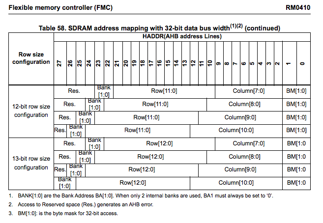

I noticed two things by re-reading the RM :

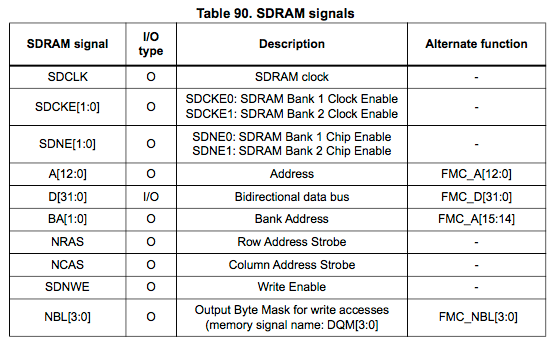

Here I see that BM[1:0] is a byte mask for 32-bit access.
And here :
FMC_NBL[3:0] Seems to be related to my issue as well.

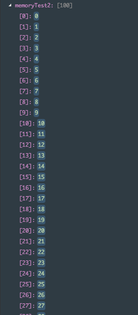

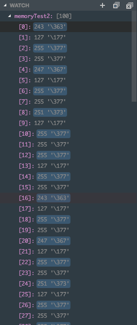

Here is what I get when I try to write UINT32 elements in SDRAM set to 32b width (Code in my previous post) :
As you can see, everything's fine.
Now here is the result for a uint8 tab :
As always, thanks for your time.

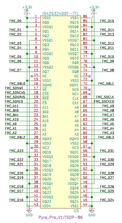

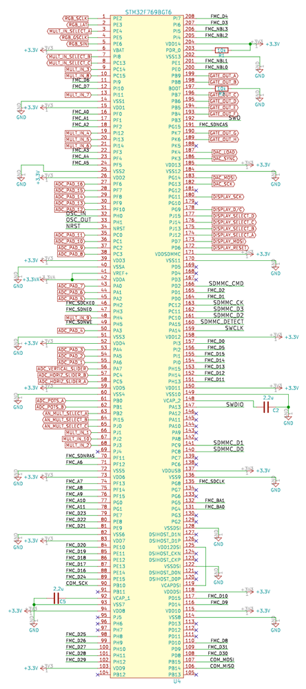

Here is the pinout :

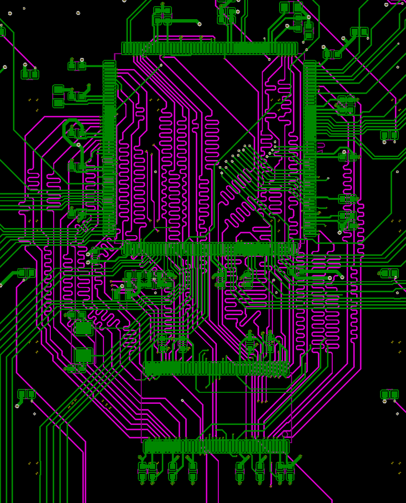

And here is what the length matched traces look like:

The pin diagrams here are unreadably small/low-res

2019-04-04 10:01 AM
Suggests a more pin level issue. Figure several hours of work to unravel
