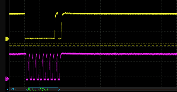

I'm trying to implement I2C on pins PC6/7of the STM32F446RET, which as I understand can only be used in FMPI2C mode.
As such, I'm trying to use the Standard Peripheral Library since the rest of our codebase utilizes it and we do not currently include the full HAL driver library. Unfortunately, there's no documentation on this module of the library (the entire helpfile section on FMPI2C is blank) so I'm going in blind.
Here's what I've been doing so far as a simple test (just sending a sequence of bytes over the bus:

FMPI2C_GenerateSTOP(FMPI2C_Per, ENABLE);However this only results in a single byte of 0x00 appearing on the line, with nothing further:
No matter what values I try to send, I only get the above result. I would appreciate any additional guidance to get this working. Thanks!
