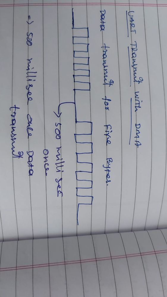

To better understand your use case and according your diagram, you want to send 5 bytes with UART and DMA, then wait a delay of 500ms ... send again 5 bytes and so on ?
Regards,
Romain,
2023-06-06 3:17 AM
yes, I want to send 5 bytes wit UART and DMA, then wait a delay 500 ms. if you know guide me.

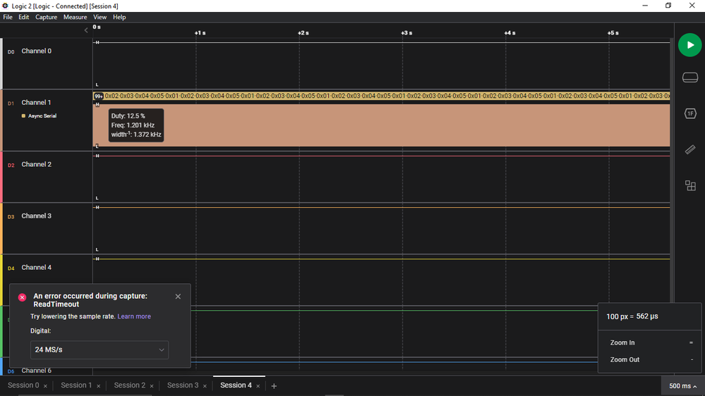

How can I generate (HAL_GetTick() - prevTick ) > 500 this delay. out is continuously send the data.
