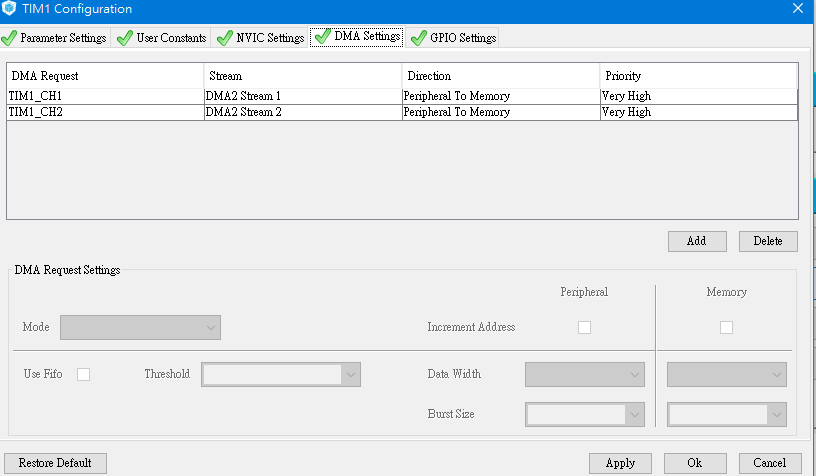

I am currently setting TIM1 as PWM Input mode following the examples in STM32Cube_FW_F4_V1.15.0
In the beginning, I am using IT like in the example, it works fine.
However, the pwm signal I want to measure runs at 800KHz.
This forces me to use DMA method to capture the values of TIM_CC1 and TIM_CC2.
the settings of TIM1 DMA is as followed:
