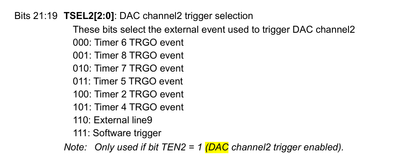

With TSEL=7, you have selected software trigger, so you'll have to set DAC_SWTRIGR_SWTRIG1 for each value. If that's not what you want, select a different trigger and enable the TRGO event from that peripheral if using a timer.
2025-11-30 11:04 AM
I know, I didn't want this to be a final solution, I wanted to trigger _anything_. No value has been triggered with my setup, it's always 0.
I will try setting up a Timer 6 TRGO event next, although this makes the code more complicated and more error-prone.
