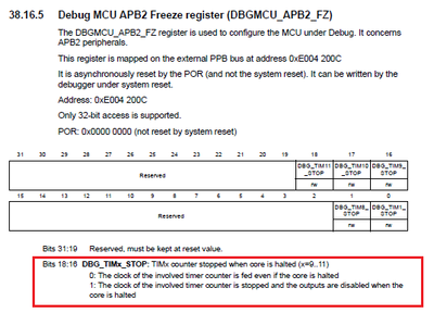

2024-04-11 6:14 AM - edited 2024-04-11 6:15 AM
Because it's not possible to stop ADC while debugging. See this thread.
The only solution I see, is to trigger the ADC with a timer and freeze its counting when the CPU is halted. This is done by writing to DBGMCU_APB2_FZ register:
See this thread.
Hope it helps.
