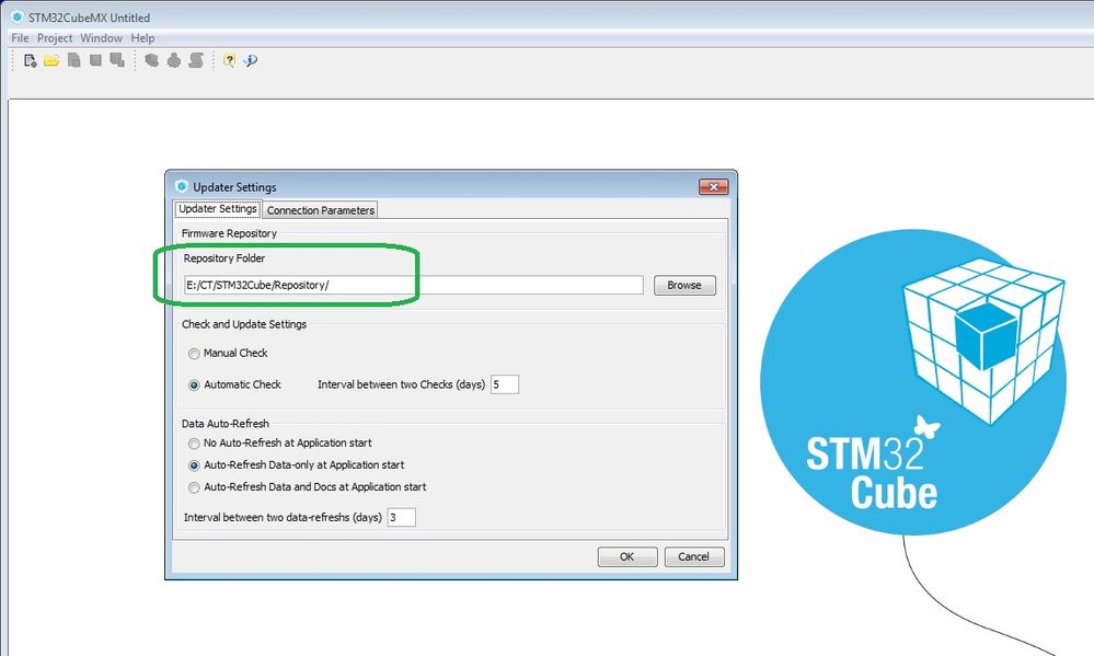

2018-06-27 8:12 AM
Go into the settings from CubeMX and look where you put the repository
E:\CT\STM32Cube\Repository\STM32Cube_FW_F4_V1.0\Projects\STM32F4-Discovery\Applications\FatFs\FatFs_USBDisk
This is Help -> Updater Settings
If you haven't installed the F4 packages, install those
2018-06-27 8:12 AM
2018-06-27 3:11 PM
Dear Clive,
the repository folder mentioned in your post is there but without any software in it. I’ve followed your hint to also download the F4cube “en.stm32cubef4.zip� and viola it contained all the examples I was searching for. Thank you very much for your help.
