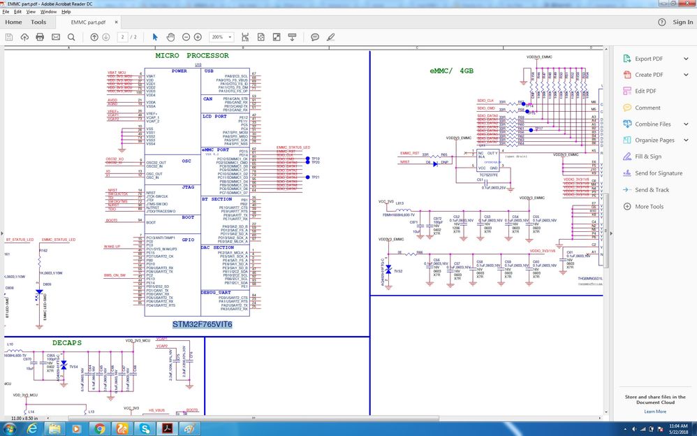

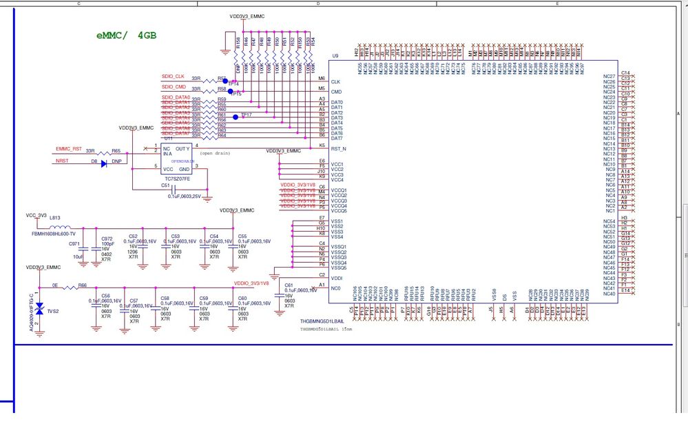

I was shared my system design details and part number pls check it and let me know

Please try attached application, should output telemetry via Debug USART (USART2 PA2/PA3) at 115200 8N1
This should identify the part and function in 4-bit mode. Not sure if eMMC is formatted. Will try 8-bit if this works.
Report back with telemetry.
