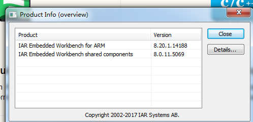

2018-08-27 6:58 AM
Which IAR version are you using ?
If you are using an older IAR version, please try to switch to the latest one.

2018-08-27 7:15 PM
Thank you for your reply. The IAR version I used is like above.
I compile the project stemwin_helloworld,I can generate HEX files, but there is a warning as shown above.Program downloaded into the development board and run, LCD does not display any text.
