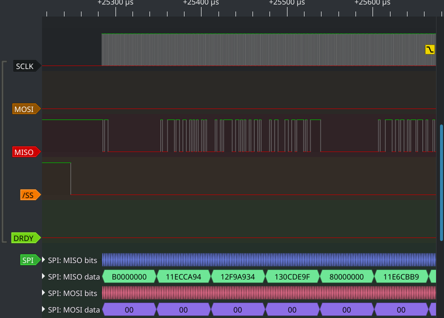

I got an IC that needs to be fed with 32bit NOP words via SPI TX (0x00000000) to get 32bit data output via RX at the same time. Communication works fine in SPI polling mode but I really want to try to do it via DMA...
My RX buffer is an array of DMA maximum possible 65535 NDTR uint16_t's. For both TX/RX SPI-DMA I use max datawidth of 16bit. (I did not yet mess with data packaging so I use 2*uint16_t per send/receive word)
What is the best way to constantly send those NOP's to the IC without creating a txBuffer of the same size as the rxBuffer (65535) until rxBuffer is full and then stop?
Is it possible to use circular mode on TX only to repeatedly send 0x0000 while RX fills the big rxBuffer?

Thanks, I think I got it. I changed the txBuffer array to an normal uint16_t initialized with 0 and changed TX MemoryAddress accordingly. I set both TX/RX datalenght
to maximum of 65535 and as suggested TX MemoryIncr. to none.
I enabled DMA RX TC interrupt and I stop both streams in it. Seems to work so far :):

} I succesfuly receive data until rxBuffer is full :)
