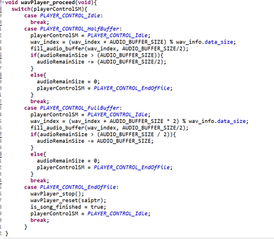

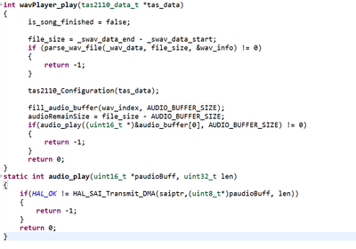

Audio Play API
static int audio_play(uint16_t *paudioBuff, uint32_t len)
if(HAL_OK != HAL_SAI_Transmit_DMA(saiptr,(uint8_t*)paudioBuff, AUDIO_BUFFER_SIZE))
return -1;
return 0;
int wavPlayer_play(tas2110_data_t *tas_data)
uint32_t wav_size = _swav_data_end - _swav_data_start;
file_size = wav_size;
if (parse_wav_file(_wav_data, wav_size, &wav_info) != 0)
return -1;
tas2110_Configuration(tas_data);
fill_audio_buffer();
if(audio_play((uint16_t *)&audio_buffer[0], AUDIO_BUFFER_SIZE) != 0)
return -1;
return 0;
Callback APIs:
void HAL_SAI_TxHalfCpltCallback(SAI_HandleTypeDef *hsai)
HAL_SAI_Transmit_DMA(hsai, (uint8_t*)audio_buffer, AUDIO_BUFFER_SIZE);
void HAL_SAI_TxCpltCallback(SAI_HandleTypeDef *hsai)

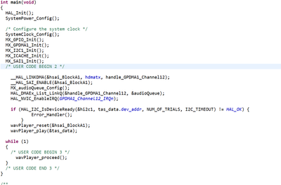

2025-09-12 3:00 AM
Hello @Jinal
According to your code attached in main.c you are not initializing the DMA;
In the MX_GPDMA1_Init() you are juste enabling the DMA clock and setting the interrupt priorities.
Please refer to the code below to initialise your DMA.
static void MX_GPDMA1_Init(void)
/* USER CODE BEGIN GPDMA1_Init 0 */
/* USER CODE END GPDMA1_Init 0 */
/* Peripheral clock enable */
__HAL_RCC_GPDMA1_CLK_ENABLE();
/* GPDMA1 interrupt Init */
HAL_NVIC_SetPriority(GPDMA1_Channel12_IRQn, 0, 0);
HAL_NVIC_EnableIRQ(GPDMA1_Channel12_IRQn);
/* USER CODE BEGIN GPDMA1_Init 1 */
/* USER CODE END GPDMA1_Init 1 */
handle_GPDMA1_Channel12.Instance = GPDMA1_Channel12;
handle_GPDMA1_Channel12.InitLinkedList.Priority = DMA_HIGH_PRIORITY;
handle_GPDMA1_Channel12.InitLinkedList.LinkStepMode = DMA_LSM_FULL_EXECUTION;
handle_GPDMA1_Channel12.InitLinkedList.LinkAllocatedPort = DMA_LINK_ALLOCATED_PORT0;
handle_GPDMA1_Channel12.InitLinkedList.TransferEventMode = DMA_TCEM_LAST_LL_ITEM_TRANSFER;
handle_GPDMA1_Channel12.InitLinkedList.LinkedListMode = DMA_LINKEDLIST_CIRCULAR;
if (HAL_DMAEx_List_Init(&handle_GPDMA1_Channel12) != HAL_OK)
Error_Handler();
if (HAL_DMA_ConfigChannelAttributes(&handle_GPDMA1_Channel12, DMA_CHANNEL_NPRIV) != HAL_OK)
Error_Handler();
/* USER CODE BEGIN GPDMA1_Init 2 */
/* USER CODE END GPDMA1_Init 2 */

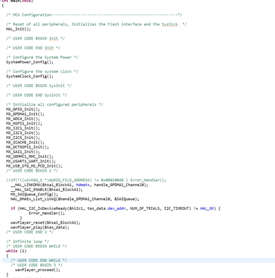

2025-09-12 5:23 AM
Hi @Saket_Om
As mentioned earlier, when I configure the channel in Linked List mode instead of Standard Request mode, I do not receive any DMA callbacks.
I have tried the same GPDMA configuration as suggested previously. For now, I am focusing only on the Linked List mode, but I am not getting any interrupts. Could you please advise how to resolve this issue?
Below is my updated MX_GPDMA1_Init function:
Error_Handler();
Error_Handler();
Could you please guide me on why callbacks are not triggered in Linked List mode, and what additional configuration might be missing?
