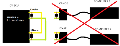

I tested it and it worked without errors for 3 minutes. After that, TEC in CAN2 and REC in CAN1 started increasing until EWGF was triggered, followed by EPVF, causing the bus to stop.
Additionally, LEC shows 010, which indicates a form error.

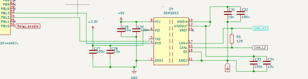

Ok. I suspect a HW issue here.. It could be something related to the transceiver.
If you configure CAN1 and CAN2 each in one of the test modes (loopback mode for example), and disconnect CAN1 from CAN2. do you face the same behavior?
But is really difficult to me think that is hardware because i'm sure that it's right, is the same as the CAN1, which works perfectly when alone.

Do you think that all the initialitzation is right? I'm not missing anything?
I also add the schematic:
