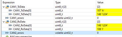

Attached a project I made for Nucleo-F446RE board:
CAN1 and CAN2 are in loopback mode. Nothing connected externally. Activated all the possible CAN errors.
Nothing happened, CAN1 and CAN2 "transceive" both the frames correctly and none of the activated errors has raised.
Please run this FW on your board, open the "Live Expressions" and check especially CAN1_errors and CAN2_errors.
As you can see from my debug session screen shot, CAN1 and CAN2 are receiving messages in loopback mode without errors:

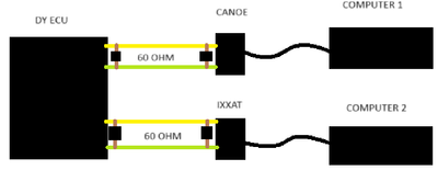

 Could you please provide a sketch how you did connect CAN1, CAN2 and "CANoe" ?
Hello, thanks for your reply.
What i wanted to explain is that my problem starts at the point where i activate the notificacions from CAN2, before that, everythings works as expected with no flags rised or crc errors detected.
Here is the configuracion i used (sorry for the bad quality but i did it fast).
Also tried to connect both peripherals to the canoe interface with the db9 wire set that comes with the package (one interface is able to receive two separated can networks in the same db9) and the result were the same.
As you can see the resistance on both can networks are 60 ohms, i also had that problem with the nucleo board with this microcontroller.
No. You need 120ohm terminating resistors in both side of the bus.

Yes, I have two 120-ohm resistors at the end of each node (because in this test, I only have two nodes in every network), and 60 ohms is the network resistance.
