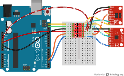

I also found a post (using an arduino) with someome having the same problem as me. He solved it by using a shifter :
With that in mind, I guess it's possible to make my own level shifter ? :) (I don't have one :/)
So i'm going to try that out tomorrow and keep you updated...

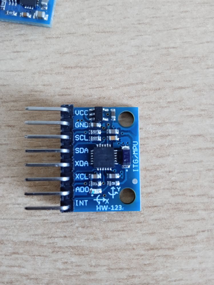

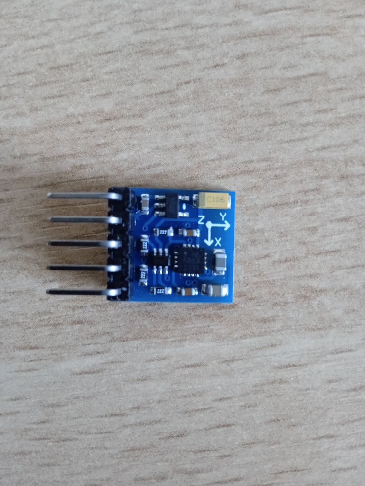

For the pics, I have a poor quality camera with my phone but here it is :
For the first sensor on the first photo it is the magnetometer behind it is written GY-271 and HW-246
On the "chip" it is written "HA 5883 2131".
The second sensor is the mpu I can't really read what's written on the chip.

2024-05-22 5:27 PM - edited 2024-05-22 5:35 PM
The Green is the pull-up / level shifter, the Orange is the "5V/VIN" side 2K2's.
The Red is the 3V3 Regulator
I'd probably lose the orange resistors and the 6-pin IC, and then bridge the SCL/SDA at the pull-up to the respective pads on the ones removed.
