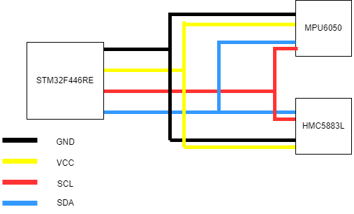

I'm trying to use MPU6050, HMC5883L and MS5611 all together in a project with an STM32F446RE. The problem is, while every components all work fine alone, when is use MPU6050 and HMC5883L together, it doesn't work. By not working, I'm meaning that the datas collected are all wrong. What's also weird is that : MPU6050 and MS5611 work fine together, same for HMC5883L and MS5611.
So let's focus on MPU6050 and HMC5883L only I guess...
For the connections I just did that :
So in my case, I connect the two sensors to the same SCL and SDA. Which should work, but I suspect that the problem might come from this connection. Indeed, even thought I'm assuming the right addresses are written in the code, could it be possible that troughout I2C, parts of the data are overwritten ? If so, what can I do ?
If you have any other ideas of where the problem could be, feel free to share it ^^
I attached all the code i use.
Thanks for your help !

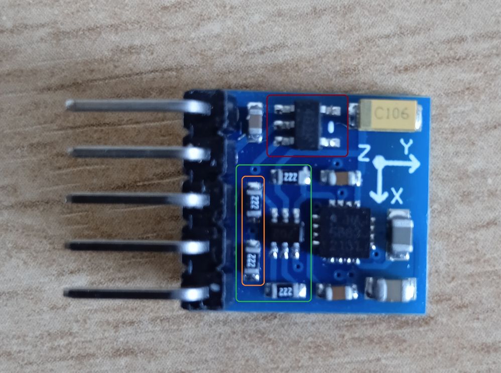

2024-05-22 5:27 PM - edited 2024-05-22 5:35 PM
The Green is the pull-up / level shifter, the Orange is the "5V/VIN" side 2K2's.
The Red is the 3V3 Regulator
I'd probably lose the orange resistors and the 6-pin IC, and then bridge the SCL/SDA at the pull-up to the respective pads on the ones removed.

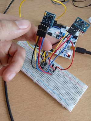

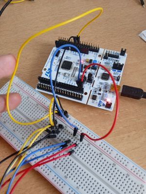

This is not a combo module, the two sensors are apart, i'm going to show pics of my montage so you can have a better idea : (colors mean the same as the colors in the diagram I sent)
Hope you can see everything fine.
I'm honestly even more confused now.. x)
2024-05-20 1:36 AM
So arguably circuit a lot more complex than diagrammed?
Link to module schematics?
VCC is what here?
Pull up resistors on every board?
