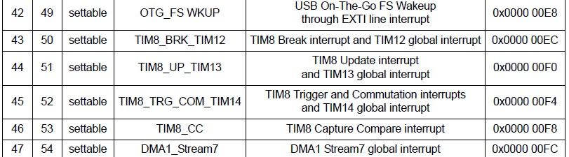

2015-08-12 4:57 PM
startup_stm32f446xx.s
DCD OTG_FS_WKUP_IRQHandler ; USB OTG FS Wakeup through EXTI line
DCD TIM8_BRK_TIM12_IRQHandler ; TIM8 Break and TIM12
DCD TIM8_UP_TIM13_IRQHandler ; TIM8 Update and TIM13
DCD TIM8_TRG_COM_TIM14_IRQHandler ; TIM8 Trigger and Commutation and TIM14
DCD TIM8_CC_IRQHandler ; TIM8 Capture Compare
DCD DMA1_Stream7_IRQHandler ; DMA1 Stream7
stm32f4xx.h (446 section)
OTG_FS_WKUP_IRQn = 42, /*!< USB OTG FS Wakeup through EXTI line interrupt */
TIM8_BRK_IRQn = 43, /*!< TIM8 Break Interrupt */
TIM8_BRK_TIM12_IRQn = 43, /*!< TIM8 Break Interrupt and TIM12 global interrupt */
TIM8_UP_TIM13_IRQn = 44, /*!< TIM8 Update Interrupt and TIM13 global interrupt */
TIM8_TRG_COM_TIM14_IRQn = 45, /*!< TIM8 Trigger and Commutation Interrupt and TIM14 global interrupt */
DMA1_Stream7_IRQn = 47, /*!< DMA1 Stream7 Interrupt */
I think something is hosed up there, TWO TIM8_BRK interrupts. Will consult the DM and RM
Try:
TIM8_CC_IRQn = 46, /*!< TIM8 Capture Compare Interrupt */
2015-08-12 5:12 PM
RM0390
2015-08-12 7:57 PM
Oh yeah.. wow, good catch! I guess that's what I get for using such a new part :p Oh well I got TIM1 working now.
