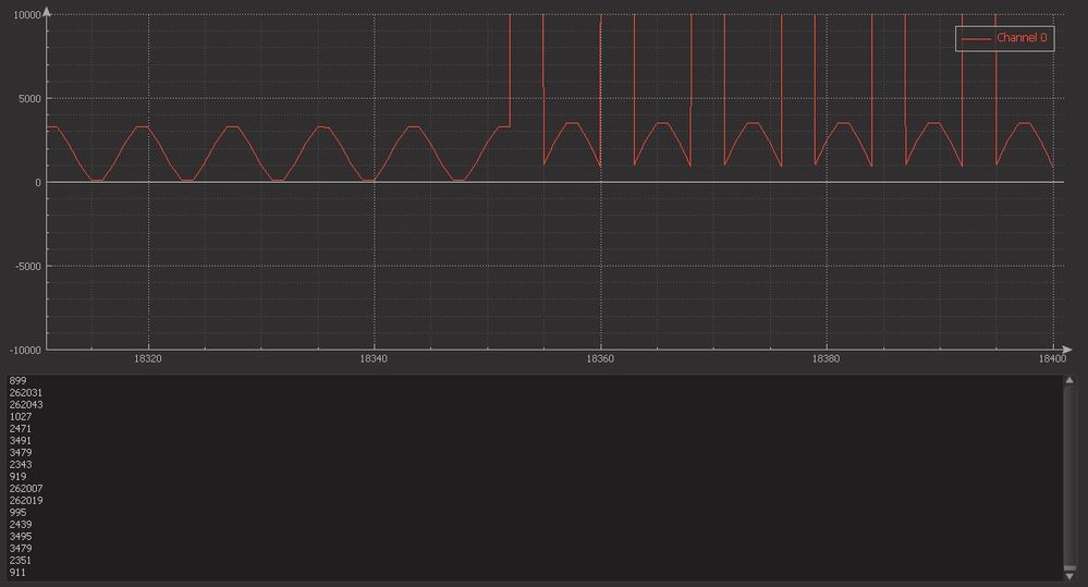

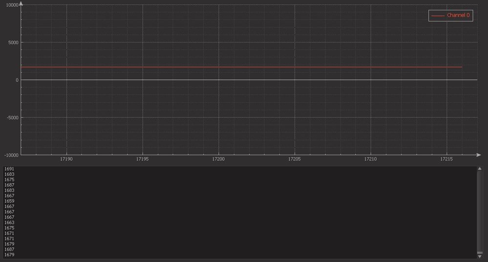

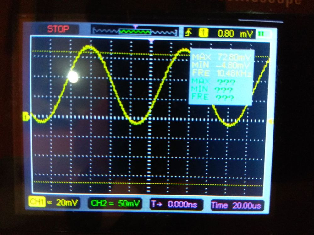

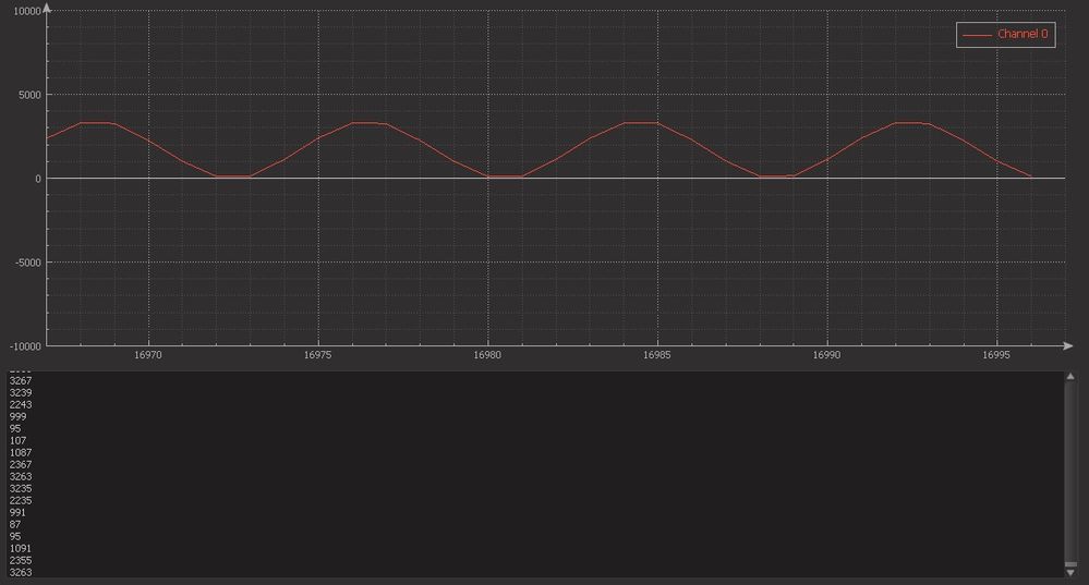

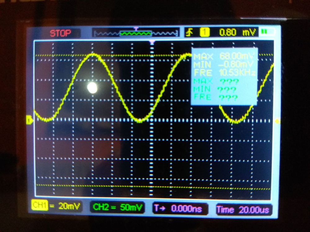

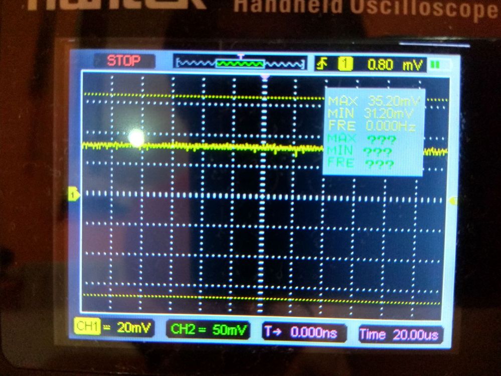

Hi
I'm adding a few photos that show my problem with ADC in the first two photos is ADC without the input signal on the other two is the signal OK until it exceeds a certain value and then the output data will start to deform as seen in the last two photos. The signal displayed on the Oscilloscope is measured on 3.4 ADC pins.
2020-01-29 2:49 PM
Looks like signed values interpreted as unsigned.
