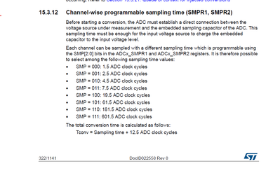

This sounds more like you have an electrical / ADC configuration mismatch, i.e. the configured sampling time and Vbat input impedance don't match.
As explained here occasionally, the input Sample&Hold stage of most ADCs can be viewed as an RC element. With a S&H capacitor (see datasheet), the RC time constant is largely defined by the components attached to the AIN pin, i.e. the input impedance.
If the source in not able to charge/discharge the S&H capacitor in the configured sample time, you get wrong results.
Either try longer sampling times, or a buffer amplifier.

For another STM32 MCU, but the concept is the same for all SAR-ADCs :
I don't do, Cube / HAL, but I'm sure you can figure this part out.
