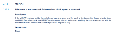

I found in the errara sheet this entry:
Is this somehow related?
