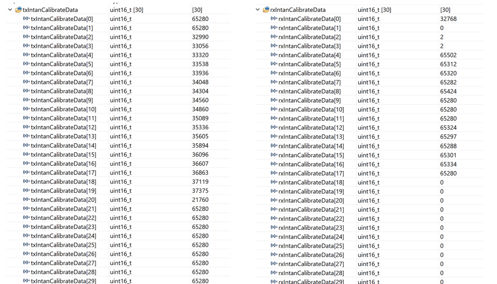

I control an ADC with SPI interface of the STM32F44 microcontroller. The ADC datasheet is in the link, https://intantech.com/files/Intan_RHD2000_series_datasheet.pdf . I set up global variables as read, write, and calibrate masks. The I call them with certain sequence based on the datasheet suggestions. But based on the transmitting values, the receiving value are not matching? For example, how the rx..[2]=2 is possible? Do you have any suggestion about the problem?

2023-04-19 7:52 AM
Sorry, I fixed the problem about getting values 0. The values in my first thread are expected based on the support team suggestion of the chip company. Such as txIntanCalibrateData[2], is 32990, or in binary, 1000 0000 1101 1110. This is a WRITE to register 0, with 8 data bits 1101 1110. You can then see rxIntanCalibrateData[4] (2 commands later), you get 65502, or in binary, 1111 1111 1101 1110. I just wonder why I see the expected values 2 commands later? Ideally, it should not be monitored at rxIntanCalibrateData[2]?
