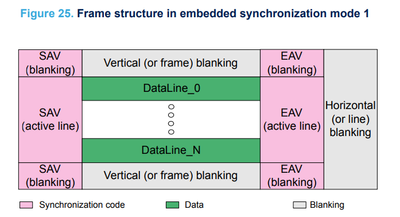

Are you using Embedded data synchronization mode: mode1?
If yes, note that the frame structure using this mode is shown below:
but it doesn't reach 240 lines. The number of lines is different each time.
How many lines you've reached? Are you using Image resizing feature?
