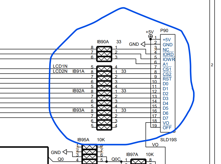

I'm trying to capture the signals as shown in that socket using STM32F429I. That socket communicates from a CPU to another LCD. The STM32 is acting as man in the middle, so I will forward these signals to another LCD of my own.
So My idea not sure if its correct or not, is to use Timer2 as a trigger, and acting on IOWR (PA0), I should start DMA transfer, and copy the data bus (latch, all signals) save them in a buffer and process them.

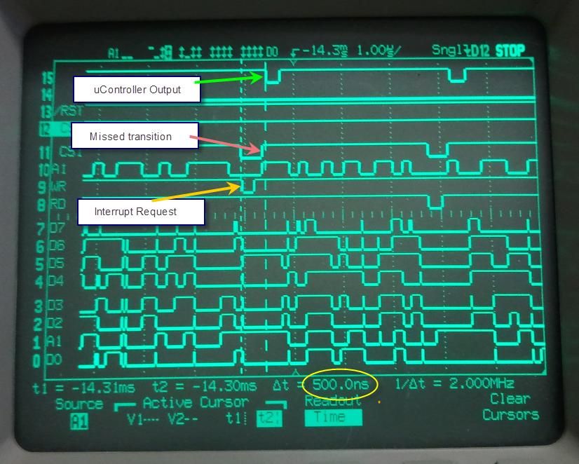

So basically you want to capture all the I/O writes to the LCD and re-interpret those writes into equivalent commands/data for a different LCD? If so I'm not sure a timer-and-DMA contraption is going to help all that much.
2024-05-05 7:36 PM
Exactly. So which approach do you think it would work best ?
2024-05-06 5:43 AM
1. Arrange the signals on the F4's pins so that minimal (or no) fiddling (shifting, ORing, etc.) is needed to translate the IOWR data.
2. Understand fully the IOWR cycle flow and the write cycle needed by your other LCD.
3. Write (polling) code to extract the IOWR data and synthesize the data and control signals to be written to your other LCD. This process might be helped by a timer to generate proper control signal pulse widths as needed to your other LCD.
