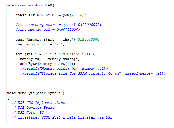

Here is a problem I'm currently working on:Board: STM32F49I-DISCOVERYMicrocontroller: STM32F429ZIT6UGoal: Access embedded SRAM (112 KB, 16 KB, 64 KB) and transfer content of memory to PC. For e.g. I am sending bytes to a PC which will eventually be a sequence of 0's and 1's that correspond to a specific memory location for the microcontroller.I've set up a template project using the STM32CubeF4 package for the IAR EWARM toolchain and it has an empty main entrypoint. I created a function readEmbeddedSRAM which has a pointer to memory address 0x20020000 which is the beginning of the memory block of 64 KB in the memory map of ARM Cortex M4 based microcontrollers (which is the core of the ST microcontroller I'm using). Now, I am reading this byte accordingly but how do I send this information to the PC? Would I be able to console output this data or send it via USB using VCOM port interface? I need the memory contents of the 64 KB SRAM in between 0x20020000 and 0x2002FFFF. I essentially need a mechanism to acquire this data. A screenshot is shown below/attached.2015-08-10 7:07 PM
Analyze it to what end?
You could dump out the hex bytes in an ASCII form, that would be readable on a serial terminal/console.For 64KB I might be more inclined to use an XMODEM-1K protocol so I could get an intact image quickly.2015-08-11 11:53 AM
