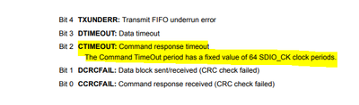

Hello @Led
The flag SDIO_FLAG_CTIMEOUT is set when a command response is not received within the expected time frame.
The Command TimeOut period has a fixed value of 64 SDIO_CK clock periods. Please refer to the reference manual for more details.

Hi @Saket_Om
Thanks for your reply. The questions remains what are the reasons for it?
With debugger I see
- In SDMMC_CmdReadSingleBlock() a command is sent to SDIO
- Then SDMMC_GetCmdResp1() is blocking-waiting for an answer.
Why should the answer not come? Knowing that writing via USB works, but writing via FileX does mostly not work.
