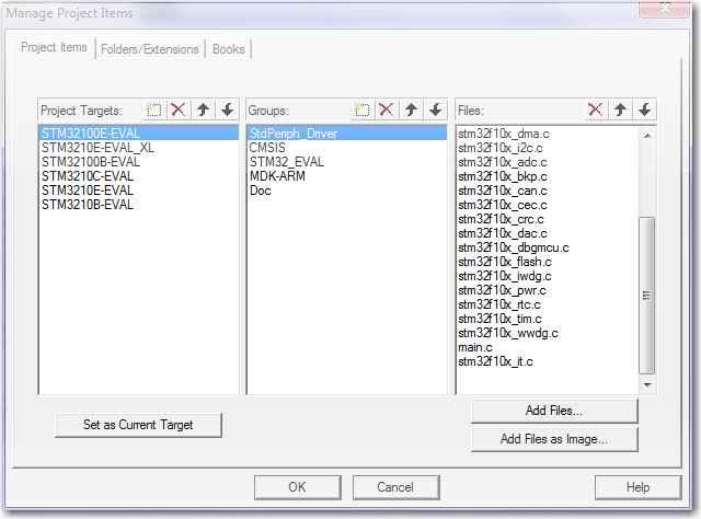

STM32F10x_StdPeriph_Lib_V3.5.0\Libraries\STM32F10x_StdPeriph_Driver\src\stm32f10x_rcc.c ? Keil projects typically store the paths to files in a relative form. If you copy the Template project you'll need to copy it at the same directory depth, or adjust up/down the paths to the files in the project meta data. As I recall you can adjust the path by right clicking the file in the project windows, and editing the properties, or deleting the file, and ''Add Existing'' to browse the tree and add them back.2015-08-16 7:36 AM

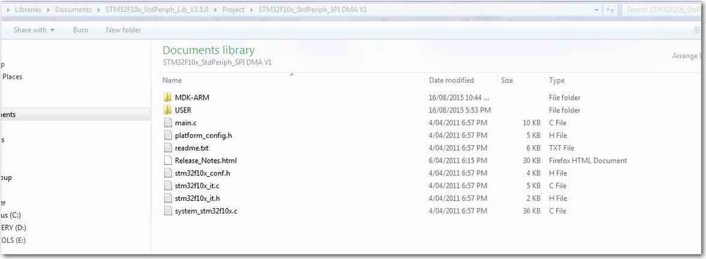

The files from

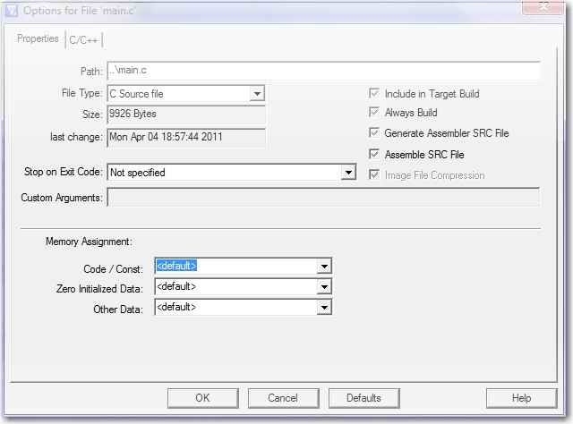

STM32F10x_StdPeriph_Lib_V3.5.0\Project\STM32F10x_StdPeriph_Template AND STM32F10x_StdPeriph_Lib_V3.5.0\Project\STM32F10x_StdPeriph_Examples\SPI\DMA Go into STM32F10x_StdPeriph_Lib_V3.5.0\Project\STM32F10x_StdPeriph_SPI DMA V1NOT STM32F10x_StdPeriph_Lib_V3.5.0\Project\STM32F10x_StdPeriph_SPI DMA V1\DMA or STM32F10x_StdPeriph_Lib_V3.5.0\Project\STM32F10x_StdPeriph_SPI DMA V1\SPI\DMA You need to maintain the same tree depth as the template, is this really that complicated? ie ONE level off the Project directoryIs the compiler using ''main.c'' from it ? Right Click on the file and LOOK at the properties about where the file is coming from. Edit the file and puts something in your recognize, and then view it with your preferred file manager of the directories and files.2015-08-17 3:02 AM

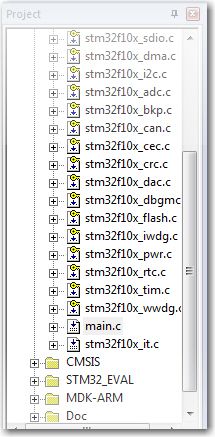

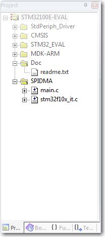

So it will be like this :
2015-08-17 6:19 AM
Looks reasonable. Right click propertiesof the file (options for file) in the project should confirm it's location
2015-08-17 6:24 AM

Yes, so one level above the MDK-ARM directory the project file is in..
