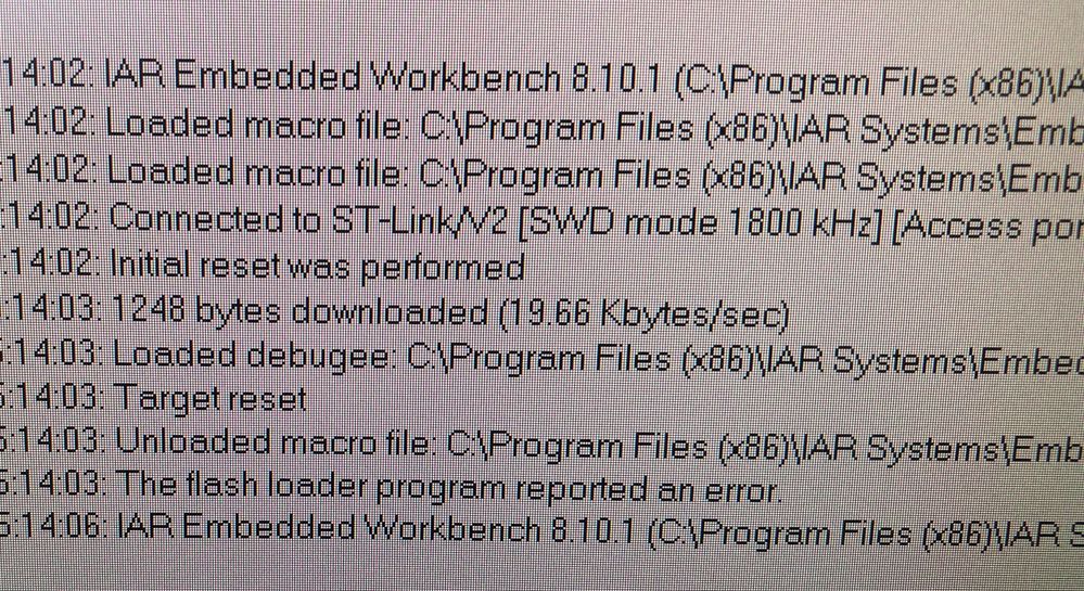

I am using IAR 8.10 with ST-Link-v2 (SWD) to develop the firmware. After building the hardware, I tried to download the program (from an example in CMSIS) to the board, but encountered a problem:
IAR pop up a question:
"Do you want to perform mass erase to unlock the device?"
I choose "OK" and the loading starts but got a fatal error:
"the flash loader program reported an error".

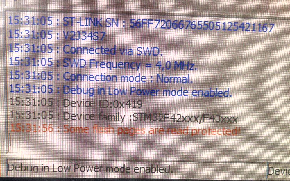

I googled this error and somebody mentioned this may be caused by the locked-chip. Then I checked the chip with STM32-ST-LINK-Utility, from where I can connect the target and see the Device ID and Revision-ID, but "unknown" Flash-size. I tried to "erase-chip" but failed because "chip is protected".

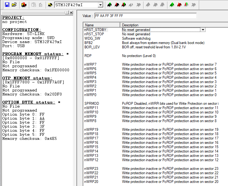

Then I use ST-Visual-programmer to remove the protection settings in the "Option Byte".After this operation, the option-byte is as following:

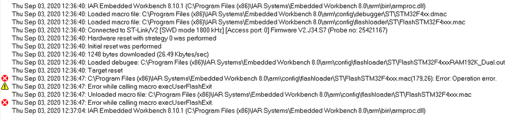

I tried to downlaod program via IAR again, and get another fatal error: "error while calling macro execuserflashexit". I can not find anything about this error on Google.
I tried 2 boards and got the same results. What caused the chip locked? and Why does the programming failed again after removing the lock?
