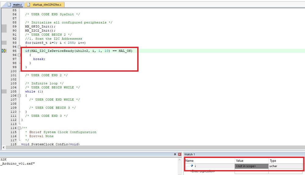

I am trying to do some examples on my STM32F429I_DISC0 board. I am new to ARM technologies. My goal is successfully connect something to my board but, I couldn't successfully do it. I thought maybe the problem was the device I connected to my board. So, I create a test device. I got myself two Arduino (1 Uno 1 Nano) and PCF8574T devices. First I create I2C between Arduino, and that was worked. So, I remove the slave Arduino and connect STM32 to PB6 and PB7 pin (as shown in CubeIDE for I2C-1). Connect them both ground too. I run the code for HAL_I2C_IsDeviceReady, but it doesn't show any value. I thought maybe there is a problem between Arduino and STM, so I switch Arduino with PCF8475T but that doesn't turn any value too.

/************************ (C) COPYRIGHT STMicroelectronics *****END OF FILE****/*By the way, I forgot to say that, I thought maybe board PB6 and PB7 (I2C-1) may not work so I change the package with I2C-2 (PF0 & PF1). That doesn't work either.
SDA of PCF8574T is connected to PF0 and SCL is connected to PF1. the line is connected 5V via 4.7K resistors.
I am not sure what might be wrong. I checked a couple of tutorials on youtube, they worked but I failed from somewhere.

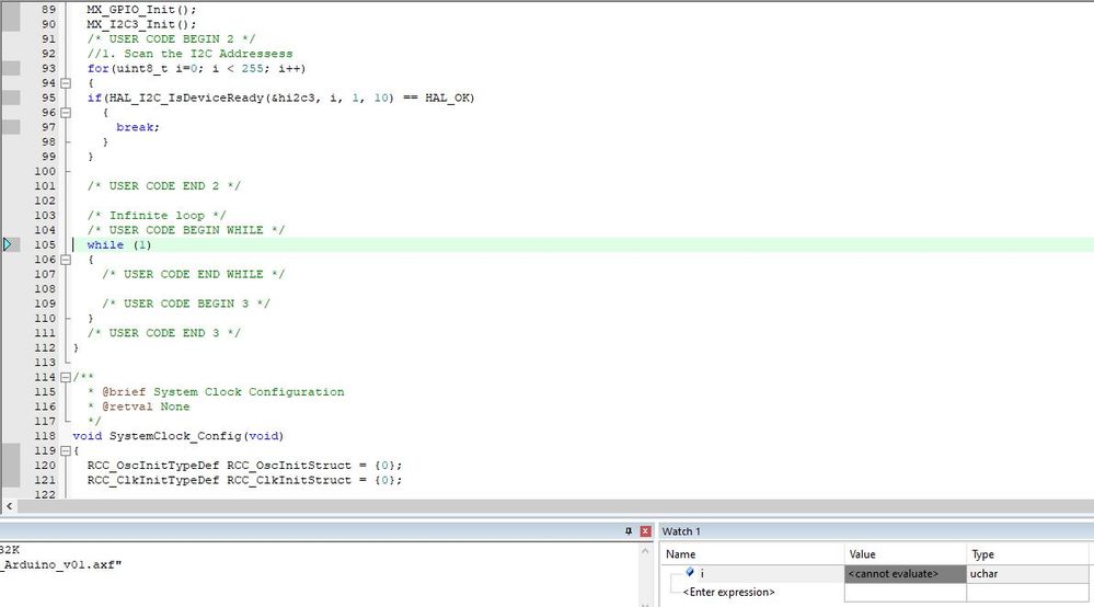

Firstly, thanks for your kind response and your attention.
I switch the I2C2 to I2C3. As you said I checked the reference manual. I connect the Arduino a4, a5 pins since they are responsible for I2C at Arduino.
A5 -> PA8
A4 -> PC9
both terminals connected 5v (of Arduino) via 4.7k Resistor
the Arduino and STM ground connected together.
Still, I couldn't read i value.
I wonder that is a wrong idea to use HAL_I2C_IsDeviceReady for Arduino?
For the time I activate, HSE -> Ceramic Resonator
In Sys, Debug -> Serial Wire
I am not sure what else I should do?
