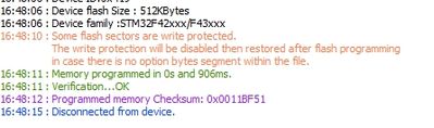

In some of the products we developed with STM32F429, we received the write-protected error I mentioned in the image. I know how to turn off write protection, but I can't figure out how it activates independently. However, there are also malfunctions in other parts of the products on which I receive this error.

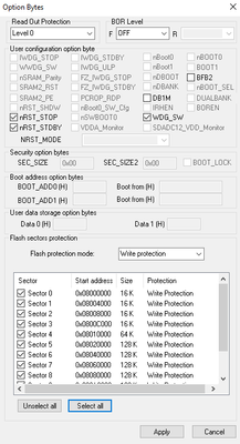

Look at option bytes in STM32CubeProgrammer. Does it agree with the statement that write protection is on? What values in there are responsible? Do other option byte values look corrupted as well? Does your program modify option bytes at all?

I'm using ST-Link Utility. The pic shows the option bytes when write protection is activated. Yes, it agrees with the statement that write protection is on.
My program doesn't modify the option bytes and internal flash.
I did some power cuts while applying option bytes. Then all option bytes changed, not only write protection. In my issue, only nWRP changes(all sectors).
