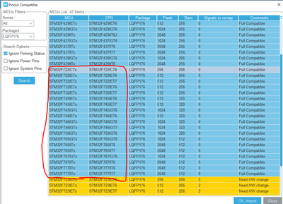

I am working on a design using the STM32F429 176pin LQFP 2MB device. Is there a F7 pin compatible part?
2023-08-31 1:49 PM
STM32CubeMX can be used to find pin-compatible parts. In this case, there are quite a few.
Note that firmware isn't going to be compatible between them, but the same board could be used.
