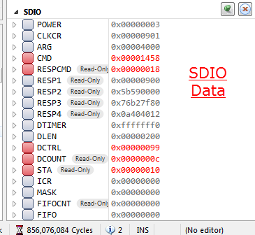

Here is were I'm puzzled because the following are register values for the Stream and SDIO

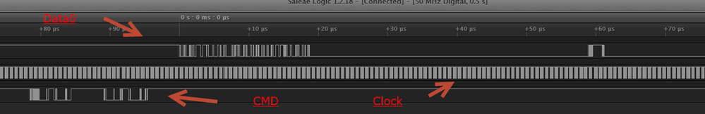

My code is posted below. If someone can help identify what I'm doing incorrectly I would appreciate it. I also have pictures below of the DMA and SDIO register states and a trace of the SDIO CLK, CMD and Dat0 lines for the write process listed. The trace shows 2 commands. the first is a SDIO CMD 13 for status followed by SDIO CMD 24.

Viewing the FIFO in the debugger is likely to break things.
For the F427 make sure NOT to enable HW FLOW CONTROL
DMA will complete well before SDIO is complete, you should spin on FIFO count until EMPTY

Viewing FIFO in debugger is only after 20 second timeout expired.
I'm spinning on SDIO_STA_DBCKEND which is well after FIFO count goes to zero.
Thanks for your comments but I don't think they identify the issue.
